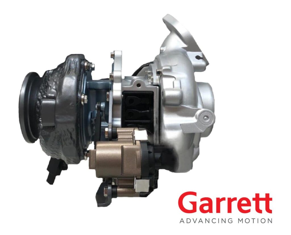

Garrett’s E-Turbo keeps this basic concept but adds a small electric motor on the shaft between the two wheels, which allows two new things to happen. First, the electric motor can spool up the turbo to provide boost immediately off idle, effectively eliminating the lag between the time a driver hits the accelerator and felt acceleration. Electrifying the turbocharger also removes the design constrants prioritizing turbine efficiency at low engine speeds to drive the compressor. The addition of electric power to compensate when air flow is low allows Garrett to use a larger turbo more appropriately matched to engine’s natural sweet spot of operation.
Second and most exciting to the future of hybridization across vehicle segments, the E-Turbo can electrically recuperate spent –and otherwise wasted–exhaust energy by using a small electric motor to generate electricity and recharge the hybrid battery. This ability to be an onboard provider of electricity opens up options for auto makers in designing hybrid powertrains.
