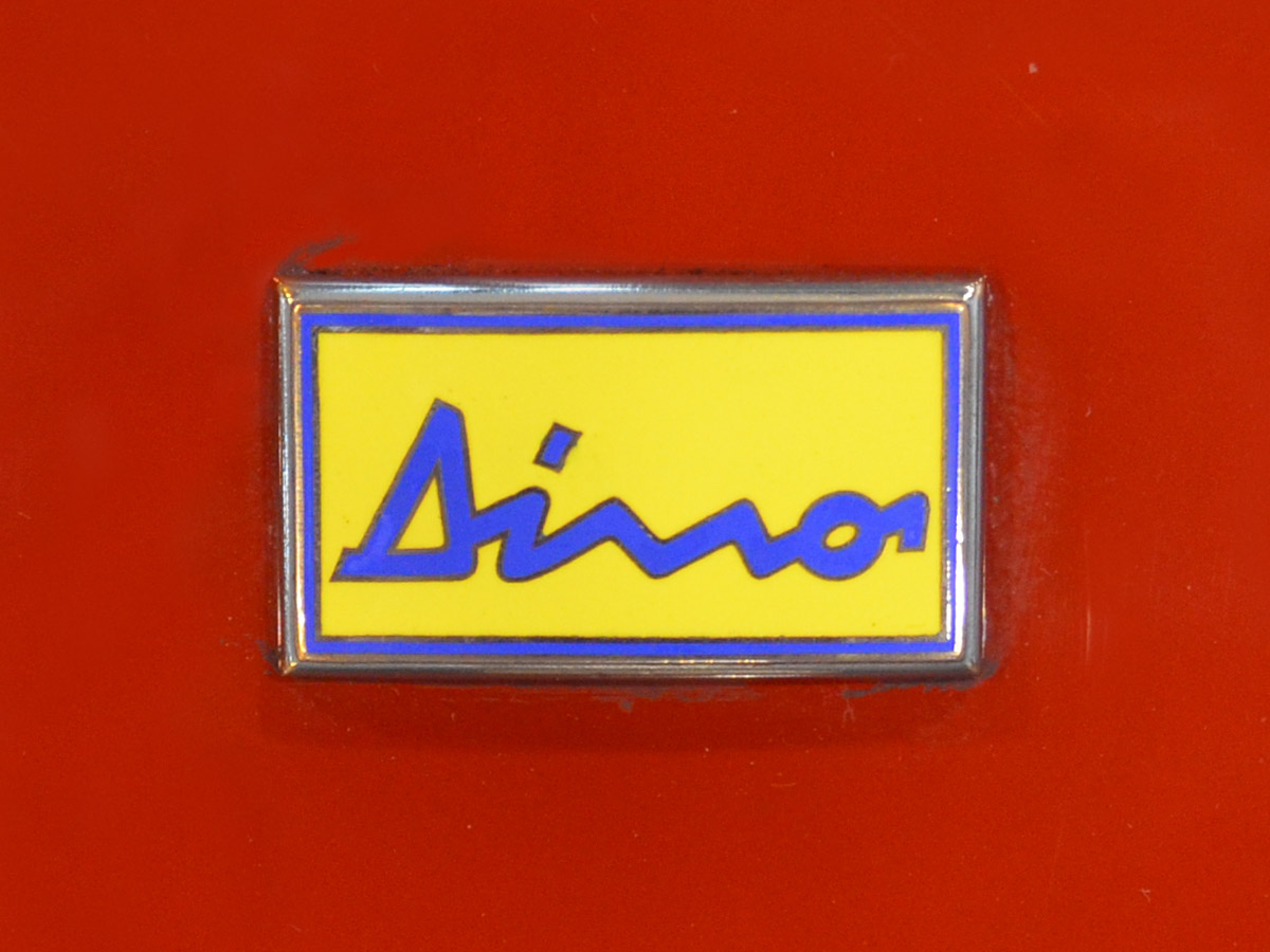

The car instantly reminded me of the Dino 246.

Dino? No. It reminds me on some other Ferraris. BTW some Dinos had Fiat made engine blocks.
